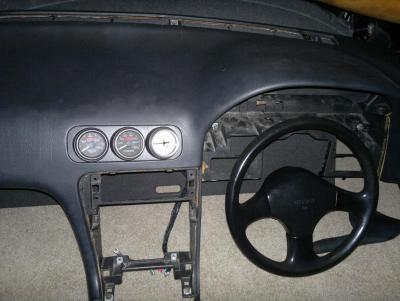

Id put them in the middle of the dash above the ac vent, all facing the driver. I had a set of defi copys with sunshades. Looked pretty cool. Its Also Legal in nsw and easy to see. As for mounting, just clean the surface with wax and grease remover and use the 3m double sided stuff from bunnings to stick em on. Worked a treat for me

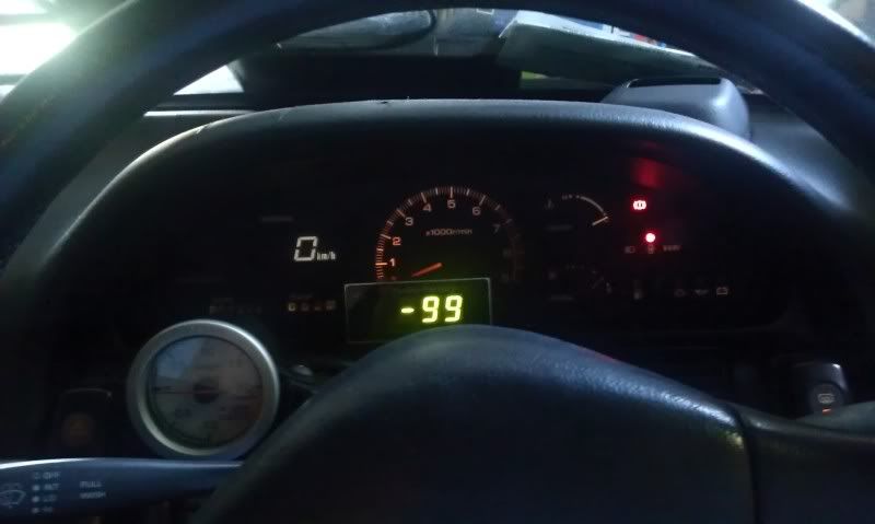

Not in NSW, and I don't believe they're legal in QLD either, for reasons of head impact and vision obstruction.
Anyway, since this thread has been resurrected, might as well post something unhelpful.
Attached Image: Cluster01.jpg
Attached Image: Cluster02.jpg
Attached Image: Cluster03.jpg

^What's that? Boost? Like kind a cool, kind of useless?

Boost and water. The sensors aren't hooked up in the pics.
I really needed them to troubleshoot some problems, and wanted them out of the way. The cluster seemed like the best place for ease of viewing, as well as subtlety.
It's totally irrelevant to this thread though. Chances are nobody will ever do it lol.

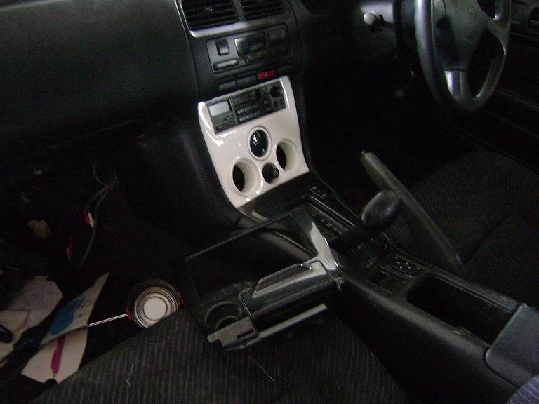

I would relocate AC controls to above or below stereo and use din setup in the AC hole
Also you can use those little sun visors to angle the the gauges with a little sanding (flip them upside down) if your just making a panel
This is my set up at the mo,. Its not a 13 though
Fibreglass replacement panel
Edited by sidies, 30 April 2012 - 03:31 AM.

^Very nice.
Since it's an auto, is the car used for drags, or just a cruiser?
If drags, are the gauges just for pre/post-run checks? Seem a little low to reference during a run.

Just a Daily , They're not to bad because the bottom ones face up quite a bit cause of the curve at bottom (hard to tell in the photo, I'm leaning ford quite a bit)) the far left one is on more of a angle facing the driver. Its more for aesthetics that one. Its actually a N/A just oil pressure , oil temp, and going to get intake temp to see the difference in temps with my intake scoop and air box on.
I'm working on a different set up now that clips to the AC controller hole I,ll post some picks when I'm done, and yes they are much easier to reference
Heres another pic you might be able to see what I'm taking about, Sh#t photo though
Ha Ha check out the state of the interior what a mess

That looks nice and neat... I have mine on the a pillar but may move them to just above the a/c vent and just 3M tape it on

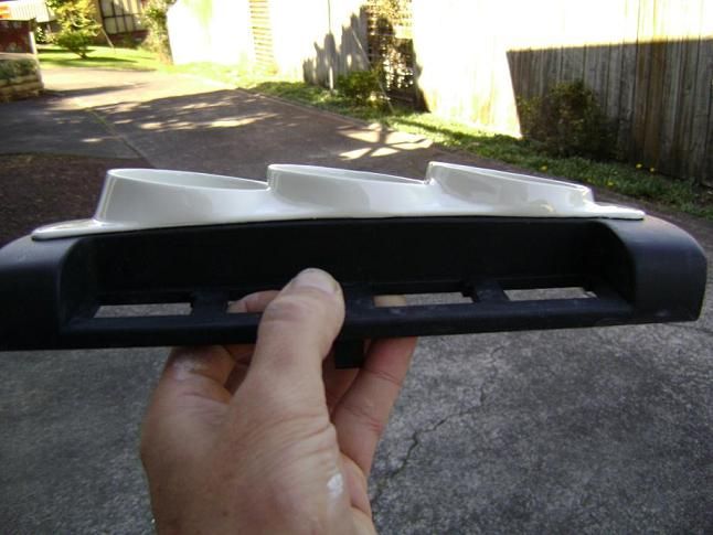

As promised the clip in setup
I think black textured coat will look better for that one, or chop and round the edges, what do you guys reckon?

I like the digital solution pmod did, however I don't think I have the skills to do that effectively (neatly).

Very nice! where did you relocate the A/C controller to?

Just below the stereo in the old pocket location, bit of messing around but worth it IMO

Main skills are soldering and using a razor knife without cutting your fingers. You should be fine.
Just buy an old cluster for cheap and if it works out, swap in the parts from the good one. If not, only 70 bucks blown.

But is it useful for fast variable data? I mean I find needle ones seam to give you a better idea of what's going on. Digital numbers might just drop like from 13 to 7psi and you have no idea what has just happened. While with the needle you can see the motion and the speed of the needle.
It would be find for like oil or water temp because that doesn't vary with such great speed. Not sure about oil pressure, it does vary (but not having one I can't comment if it's significant while driving).
