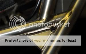

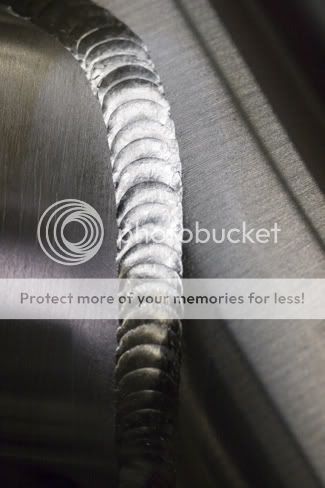

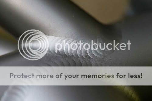

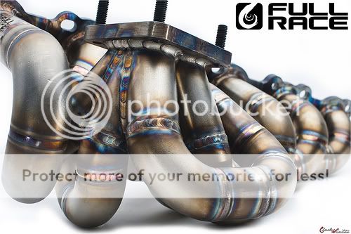

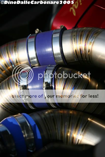

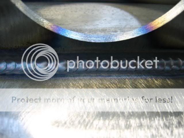

hey guys, not sure if its been posted before. but as the title states welds that make you go weak at the knee's, im sure most fabricators on here check out the welds on the stainless rails at shopping centers, or the alloy welds on general shop items such as ladders ect ect, unless im just weird ? hahaha, anywho id like people to post some pics you may have seen on the internet or even in real life of the most sexiest beads you have seen, doesent matter what material mild/alloy/stainless/titanium ect ect.. some are probley going to be done by machine but its still something that can be stared at for hours and hours. ha. heres a couple of pics to kick it off :

That very first picture....oh my gawd....

Awesome idea for a thread. That manifold is a nice piece of gear!
