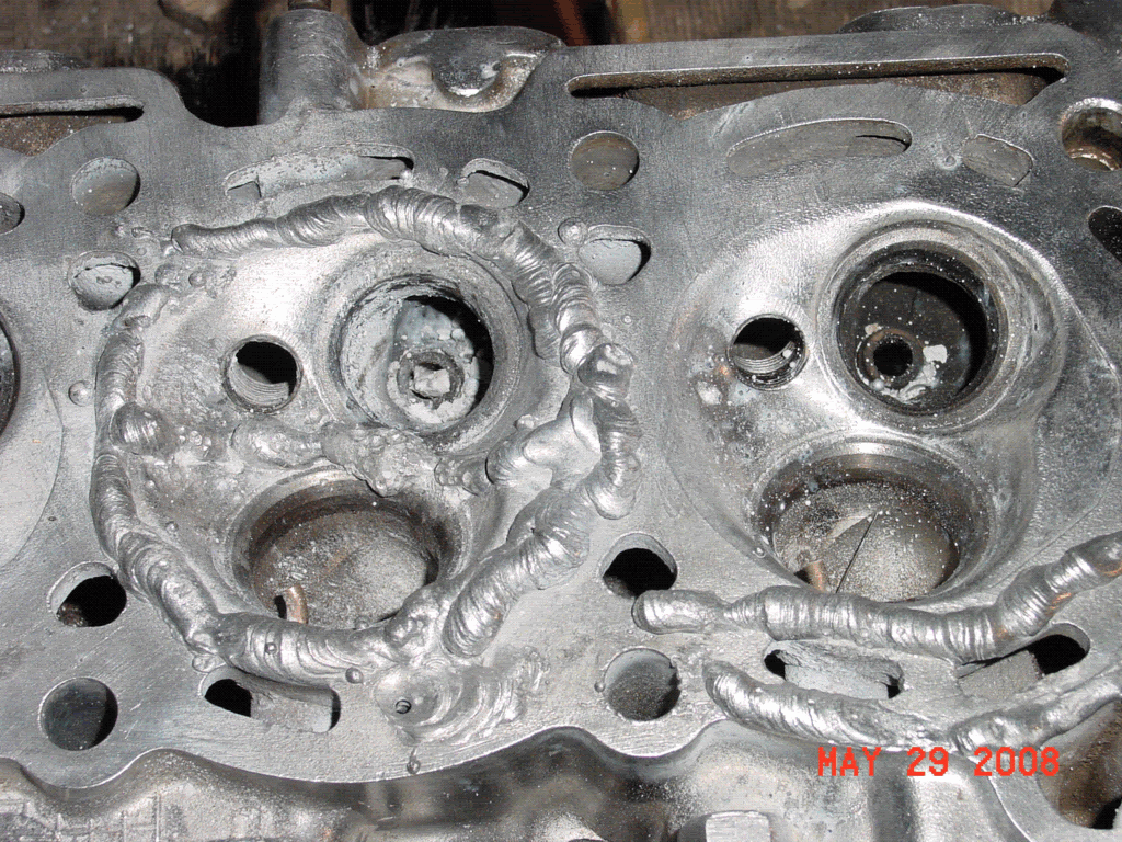

oh dear god

what on earth were they trying to achieve there?

Posted 26 March 2012 - 11:13 AM
I'm wanting to believe that it was just a person practicing some alloy welding. Heh
#249 Simon-S14
  • Joined:18-May 04
Posted 26 March 2012 - 11:46 AM
With a mig no less

For those of you who are raving on about the cylinder head picture posted
It's not that bad I know it looks bad but it doesn't matter
I use to work in a engine reco workshop and when u need to weld up water galleries , weld jp valve seats to repair rust it doesn't matter how it looks because once u grind it back and surface deck the cylinder head u won't be able to tell because most of the weld metal will get machined back
But that one picture does look pretty bad dunno what the hell happen there
When a cylinder head is that f***ed it needs that much welding we would normally tell the customer to buy another 2nd hand cylinder head

Agreed.
You can certainly do that, but obviously with better techniques. As Kemp said, it'll get machined down to look schmick again anyways.

for the time it would cost to get it smooth,would be ezyer and cheaper to get a new reco head.

No it's not
Depend on how much repair work is involved
If it just one or 2 even 3 different repair spots it's still cheaper to weld them up, grind them back and then surface deck the cylinder head
When surface decking a head it's easy
Bolt the cylinder head so it's level
Set height
Set speed
And away u go
Not much involved the machine does all the work for u

That head sorta looks like a FE head of like a ford econno van, mazda van ect..
You would be surprised what gets repaired on heads. Buy a "new reco head" do you mean a brand new head or a reconditioned head? as thats a poor example of head repairing in that photo. But once all done that equals a reco head.
Any new heads of the shelf it is best to get surfaced and checked out to your engine builders specs as their not as good as they could be. So either way they get machined.

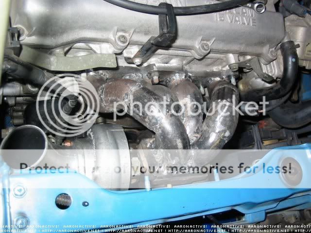

lol that is on a k11 micra

seems legit
