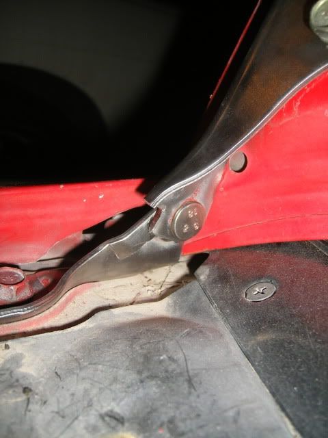

Hi guys just wondering how people are modifying their bonnet hinges on a s13 so the bonnet sits upright by itself?
Any advice would be greatly appreciated, I would post a photo but Im not sure how.

Just lift the bonnet and you will notice tab on the hinge that hits and stops it from going any further. cut this tab off. and you will be able to put the bonnet all the way back to the window.

As xris says but file tab back. U still want friction and tension on it when vertical makes it less resistant to be blown back over

u dont need to... use a hammer and chizel, bend that tab back

my 14 seemed to have more of a buldge thana tab...
just took the bonnet off and attacked it with a grinder, hindges still on the car...
managed to make it work :lol:

thanks guys will use hammer and chisel tomorow
