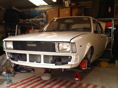

thought i better upload some pics of whats happened so far
This is just after i bought the car, i wheeled him in and put it on stands
Attached Image: KE70 1 small.jpg
