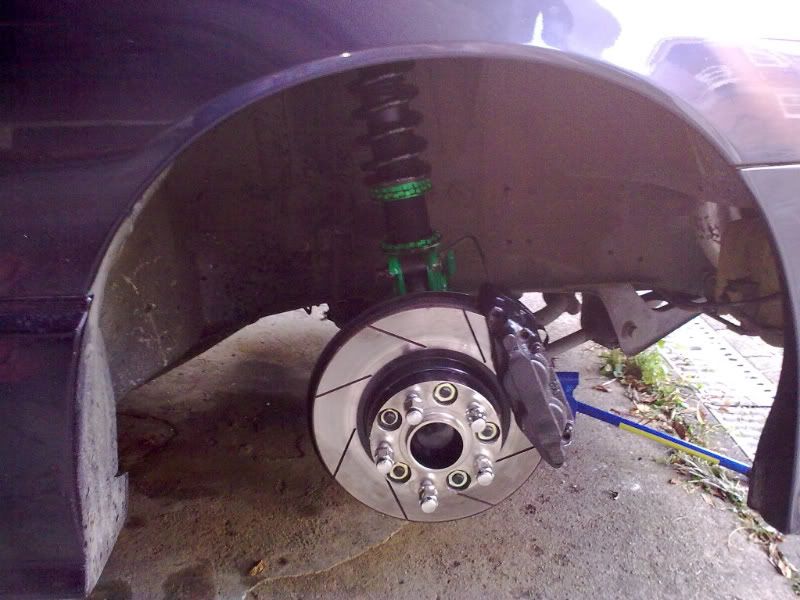

Right. Well we had a little problem. I ended up going to Just Jap and bought 20mm for the rear and 15mm for the fronts.
Got home, got the wheel off, put the spacer on, bolted her up and then noticed that the hub studs dont sit flush with the spacer, they are long enough to poke through, about 10mm. Posted Image
So when i went to put the wheel back on, the wheel sits against the studs, not the spacer.
Now, do you think this is a simple matter of just getting 30mm spacers? I spoke to Just Jap and they said to come back and they will sort it out for me one way or another.
Just thought i would ask you guys first and see what you thought.
Either way it looks like im going to have a set of 20mm spacers for sale soon, as because ive already had them on the car, Just Jap cant take them back. Posted Image

#18 AnDyStYLe
  • Joined:31-January 05
  • Car:RPS13
Posted 14 November 2009 - 10:08 AM
Mate that's not a defect of the spacers. Obviously the studs protuding 10mm out is due to the width (lack of width for that matter)of the spacers. Usually your rims will have slots to accommodate this. If not, you've next bet is to either go larger spacers or source shorter studs.
If you do go larger 30mm spacers, you need to think about track and scrubbing.
Cheers,
Andy
#19 Chidge
  • Joined:02-November 09
  • Car:3 SP25GT
Posted 14 November 2009 - 10:25 AM
Yeah thats what i was thinking. I think i might just go for the 30mm spacers and see how they go. I'll get around it somehow.
Thanks for your help Posted Image

#23 Hawker180
  • Joined:26-June 05
  • Car:180sx + Landcruiser
Posted 16 November 2009 - 08:38 AM
thats why you angle grind the studs down to suit the smaller bolt ons.

#25 Chidge
  • Car:3 SP25GT
Posted 16 November 2009 - 05:05 PM
Haha i was seriously thinking about doing that.. But then thought what happens if i want to take the spacers off.
Its all good, went down to Just Jap today n swapped them for 30mm spacers. Just have to wait for them to come in. Spewing coz i wanted them to be done for the cruise.
