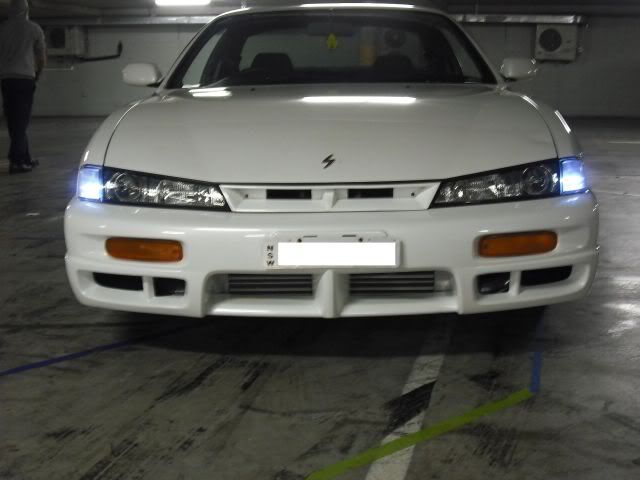

So i have mixed opinions regarding my front bar.I have some free time tomorrow & want to cut the front bar so the FMIC has no air flow restirctions.
Currently my front bar restricts some airflow directly blocking the cooler..
Need some opionions , Wat u think ? No going back once cut...

If you cut it then it will be WORSE for cooling, the air will just flow around the cooler rather than like now where the stock bar guides it in.
you would be best to chop it neatly at the top and bolt your number plate up higher.

Yea the bottom of the bar actually helps with aerodynamics. If you cut out the bottom you'll get worse airflow like Hawker180 said above.
That and it looks like aids without the bottom.. I say if you're going to cut it just cut the middle beam out and fibreglass it flat over the cuts. :thumbsup:

Air will just go under the cooler and not through it if you do cut the bottom section out.
