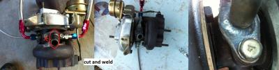

do this... no more loose bolts... ever :)
Attached Image: WP_001194.jpg
Attached Image: WP_001203.jpg
Attached Image: WP_001205.jpg

looks legal. lol

View PostS13 Track Hack, on 26 March 2012 - 06:09 PM, said:
do this... no more loose bolts... ever Posted Image
Haha, love it. Tracking it on a rainy day would suck though. Considered welding a 90 degree bend to the tip and expanding the cutout to suit?
I had to weld the dump to my old T25 after snapping 3 bolts in the turbine housing.
Damn sight cheaper than paying for replacement gaskets, bolt removal or helicoils.
Edited by pmod, 27 March 2012 - 08:54 AM.

i dont replace studs unless they are damaged
u can reuse the T25 oil drain on a T28 turbo BUT i personally like to cut the pipe of the flange and weld it at a different angle so there is less kink in the rubber hose
this does not have to be done its just some thing i like to do
Attached Image: IMG_0815.JPG
