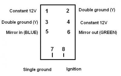

1) Constant 12V (brown)
2) Constant 12V (brown)
3) First Ground (black)
4) First Ground (black)
5) Ignition 12V (white)
6) Second Ground (black)
7) MIRRORS OUT (green or brown extended)
8) MIRRORS IN (blue or brown extended)
Now.
Follow this diagram and wire it to your relay terminals. If you bought a relay connector then you don't need to solder, just unscrew, fit wire, and screw.
Makes it so simple.
Attached Image: untitled.JPG
You should be finished. Go test it out.

#14 Rolled Cambers
  • Joined:14-July 09
  • Car:Nissan Silvia s13.
Posted 23 January 2012 - 01:37 PM
Hahaha!
I am working on it now!
Doing all the drawing work as we speak, then going to go apply it and hopefully.. It works.
Fingers crossed!!!!

Why do u need 2 wires to the ignition?

are you just trying to get them to fold in with ignition off? I could make a wiring diagram if needed I have done it before(a while ago i must add) let me know if stuck , I can pm some info or post it here :thumbsup:
#18 Rolled Cambers
  • Joined:14-July 09
Posted 23 January 2012 - 05:17 PM
No need. All done.
Please follow above steps.
It's simple, easy and costs a total of $50 or under. Depending on what tools you have and if you have most materials.
If you get stuck, please feel free to ask on here and I can help anyway out.
I am sure there is an easier way, but I found this to be quite easy for me.

Just Finished wiring it all, just need to buy the relay and relay holder tomorrow.
Took me a bit longer, as I soldered every join and used heat shrink on every join. And also insteAd of cutting the blue and green wire, I spliced into them, so hopefully the switch will still work? And I mounted my fuze holder in the engine bay neatly. And wired it up to "ON" instead of "ACC", thus being you basically only turn the car onto "on" if you are going to drive.. I'm my theory haha.
Really got how-to. I'll report back tomorrow and let you know how it goes.

ok for those of you who wanna use the switch in conjunction with the auto fold function!!!
where you cut the blue and green wires out of the switch I hope you left some length, so run a wire from your green wire on the relay back up to the green wire on the switch and splice together, add an extra wire from the blue wire on the relay and run up to the blue wire on the switch and splice together...
the switch will still have its power for controlling the motor as you shouldn't have touched it and the blue and green wires will now be paralleled through the switch and relay!
the switch in the neutral position will allow the relay to function for auto fold and the switch in either close or open should in theory bypass the relay (simple paralleled circuit!)
RC is totally right in what he has done and the reason for the multiple powers is to feed power to engage the relay (energize the coil) and the others is to feed power through your poles.
tip for young players!!! protect the live wire as much as possible as you dont want it to chafe otherwise it will short straight to your chassis and will potentially f**k shit up...
RC congrats on the write up very well done, glad you got it to work, bit dodgy bolting wire directly to chassis LOL, Personally I would of used terminals... but hey im a picky bastard!
As I have neither a 180 or s13 I cant try my theory though it should definitely work ( If it doesnt I shouldnt be fixing planes, haha), give it a go and if ya dont mind elaborate with pics of what ive written and make this A grade hot to thread A+ quality LOL

Cambers hide your VIN in the pictures and give your engine bay a bit of a degrease + wash :)
Awesome write up though, informative, pictures make it much easier to compare to and it works!
Does anything have to be reset or rewired if the battery dies or Can put a new one in and all will be sweet?

Beau I will try and put your side into it as well along with more pics tomorrow after work.
Haha yeah, bolt the wire, meh, couldn't be bothered, if it's solid then I'm happy, it won't move around, so it's all good (For me)
I recommend using terminals and solder for everything, but in my case, I really did not want to solder.
Cheers for your support as well!!!
Apothecary why hide the vin? People might steal the numbers??
Haha yeah engine needs a clean, maybe next year.
No the only thing that needs to be reset is your clock, and your radio channels. Apart from that nothing else is in the way. Although my radio isn't working like it was before. But that's cool.
Also the car hasn't died yet, so I think the relay is doing it's job on cutting power haha!
If the battery does die, I'll have to open everything and have a look at what's causing the problem. I doubt it will.
Edit: JTC I think your idea would actually work!! More simpler, I was tired when I was looking at the pic.
I think you could use a spdt. But I already did it. Maybe I can try it on another persons s13 lol.

Yer I'm pretty sure my idea will work, but will try to confirm, defs would advise everyone to get wire etc from jaycar, also I think it should be fine to run accessories from the cig lighter as it is only a trigger, will be interesting to see if it affects battery life at all I doubt it though.
#27 Rolled Cambers
  • Joined:14-July 09
Posted 24 January 2012 - 03:45 AM
Test it out, let us know how it goes!
I'll draw up a diagram of S15-GT's explanation and then test it out, if it works, then hey we have our selves a DIY extension thanks to him :)

UPDATE:
FYI - Wether you use a dpdt or spdt relay there will always be power to your mirrors motor!
Ok so if you do as I explained earlier then the use of the switch will inturn have to over come the relay ie: your mirrors are opened and relay energized keeping power there, you use the switch to close it, which will cause power to the mirror motor to both keep it open and try and close it! I recon this will kill the motor and if not and it works then as soon as you let go of the switch it will extend!
I hope that's a good enough explanation to make sence!
I'll work on it and get something that incorporates the switch and prevents power to the motor after it has driven the mirror open/closed

So you haven't figured it out yet?
I'm drawing shit up now and seeing if it works, but until I test it I don't know if it will or not.
